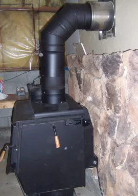

Went to the stove store & bought some double wall pipe. $400 worth. :bug: OMG
2 -- 45° at $89 each
Adjustable length straight $91
Close adapter to metal bestos$55
, stove spool $57
& some fluff covers $26
Also he said: "I should have a few degrees down angle to the stove on the metalbestos that comes into the house &
with a concrete wall behind the rock, I can move the stove till it almost touches the fans" had to to
make what he set me up with fit 1-1/2" clearance on the fan housing.
So I raised the stack 1-3/8", (not an easy chore by the way) so the angle is down 1/16+/- of a bubble.
While I was up there, clean the pipe, less than an inch in a 5 gallon bucket. more on the cap than in the pipe.
Running on lower setting now than I could before, so we'll see if it burns cooler now with no problems.
Critic it please.
Anyway old (1st pic) VS new pipe (3) pics ( in low mode in pics, did run hot & open wood door to burn off the smell)
