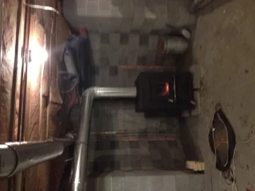

I'm just using mine like a wood stove, with the heat dumped locally. The big blower is overkill for me so I use one or two 4" muffin fans from old PC's that sit about an inch away from the cold air inlet.
I have a probe thermometer in my pipe about a foot from the furnace. At 500 it is really cranking out the heat, but will still radiate nicely even as low as 225.
