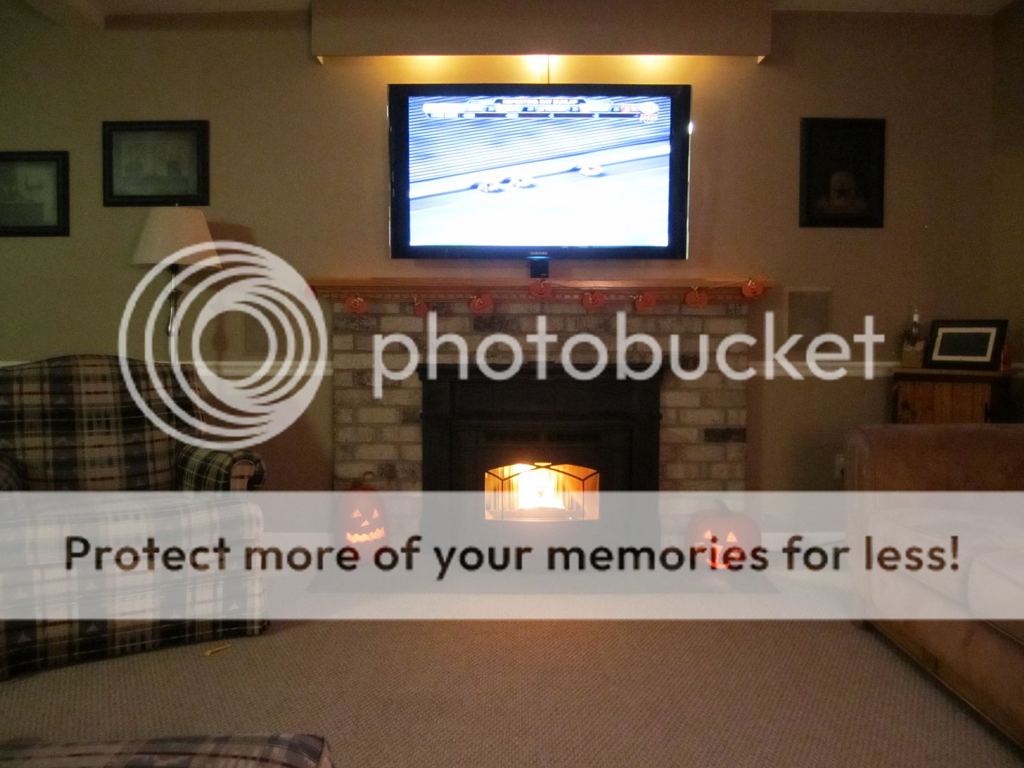

    heres a pic :)
    [IMG]
    sorry for the crappy quality, my DSLR is in the shop :(

    Pony, This only happens on start up. You get a lot of pellets in the burn pot and you will notice the pot has pellets right to the edge, and before they fully burn the agatater starts to turn and some get pushed over the edge. It does seem to be a lot of pellets. What setting do you have for the pellet quality. I have mine set on premium. You should be able to change feed and comb. settings any time after start up is finished. I dont think it will work during start up. i only have smoke on start up, after that I can make any changes and no smoke.
    Nice stove and set up. Enjoy the heat.
