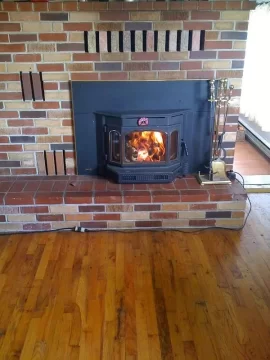

First off, you guys have really, really helped me over this past year with a wood stove purchase. Well, I finally have a quadrafire 4100I insert, and I love this thing!
The insert, is in the center of the house, it heats one side of my house great, the bathrooms, bedroom, and the upstairs with ease. There is a 20x20 family room behind the stove room, that I can't seem to get about 66 degrees even during the shoulder season, while the rest of the house hangs about from 75 to 80 with a hot burn.

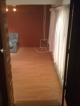

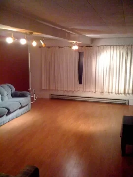

some pictures of the new stove, and the family room behind. This room sits lower than the rest, when it gets cold this winter I'm thinking it's going to be a bear to heat the upstairs, and downstairs with this insert. I have baseboard heat that I refuse to use. My power rates are pretty cheap, but, I just don't like using it.
The upstairs is right off the main stove room, and has a door I can close if I want to and keep all the heat down here. My thought process is, If I'm spending a bunch of time in the family room, I can run the stove in there with small hot fires and keep it nice and toasty, and, with the family room being below everything, it will probably help the insert out with the rest of the house.
I thought about making the family room the "main" stove room. The reason I didn't is to keep the rest of the house warm, it would have to be damn hot in that room...
