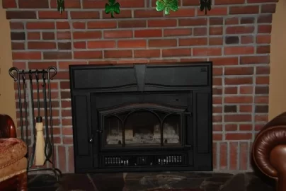

New Jotul C550 owner, have a few questions.
leakypuppy
Mar 3, 2008
103
Northern NJ
I've had my new C550 installed less than a week after waiting about 6 weeks for the units to come in from Jotul. I wasn't prepared and didn't do enough research on how to actually burn these units so after my first few burns the bricks and glass are black with soot. Since then I've started reading up on the correct methods for burning and since I'm home today will try some of the techniques I've read about now. Is it a problem that the bricks are black or is this only cosmetic? Will the soot burn off when the temp. gets up and I get secondary combustion? I was able to clean the glass with ash and water, worked like a charm.
Thanks,
-jim

I have had the same unit for a week and a half now so I can give you what I have done. The black will burn off the brick when it gets hot enough.
I usually start with some small sticks and paper. I like to use wood from pallets to get the thing going. I find that it gets going quickest if I leave the door open a crack. It helps to get more air flow. Once it starts going with the pallet wood I will put in soft or hard wood depending on what I have.
I only burn nights and weekends when I am home. It takes a good half an hour to get it going. I leave the fan on auto so it turns on when the stove is hot enough. I am by no means an expert with this. Perplexed and I have a lot of PM going back and forth about this. If you have anymore questions feel free to PM me.
Thanks. I just lit a top down fire big logs on the bottom, paper knots and then small kindling on top. I thought I had it going but when I returned 20mins later the flames were out and the draft seemed to be blowing across some of the burned areas of the bigger logs. I just put some additional kindling on and will see if keeping the door open a crack will help get it going.
