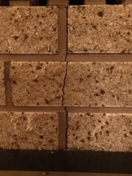

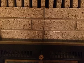

I have a related question: the section above the fireplace opening (is there a name for this?!) has a crack.
ImageUploadedByTapatalk1443494115.150684.jpg ImageUploadedByTapatalk1443494128.084719.jpg
Is this something I need to worry about? If so, what's the fix for this?
I don't have a lot of other questions. This forum is a great resource!
Looks like it may be in the surface veneer. The insert contains the fire within a firebox surrounded by a convective jacket. It looks like it is safe, but it's always better to have it checked by someone that can examine it directly to make sure there isn't a deeper problem that doesn't show in a photo.

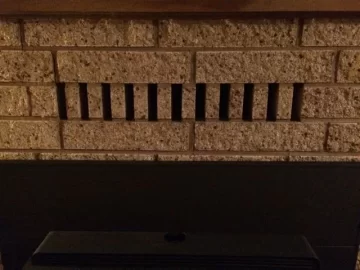

So we have these holes above the fireplace that, when it was a normal fireplace blew out hot air linked with a switch nearby that turns on a blower. Now it blows dust and cold air.
Can I plug these, and if so, with what?
How about going to a tile store to find some nice accent tiles to put in there.

Where are you putting the block off plate in relation to the vents? There's another thread where someone was asking about drilling holes in the inserts surround to get more heat out. If the plate is above the vents maybe it will allow better circulation depending on where their air intake is?
Hmm. So we're doing our first burn in and smoke is coming in from those vents. A lot when it started going. It's a lot less now with the cat engaged.
I should assume that this isn't normal?
1st burn? paint curing. Shouldn't smell like fire wood burning, should smell like oil / factory burning
I work nights, lit my stove for break in fire fell asleep woke up to a house full of burn off had the doors open to air it out for about 2hrs no wind that day ;lol normal don't worry.
