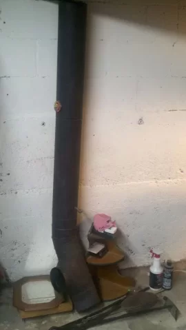

    I think the trailer might be a good idea, I will have a few people to help me unload it but I'm pretty sure the guy at woodstock said it would weigh 525 lbs crated so that's pretty heavy! Another question, my old flue setup has a damper in it, is this required? Most setups I've been looking at just have a straight shot of pipe. This stove is going to be sitting e few inches lower than my old stove so I'm going to have to purchase a piece of pipe anyway, I would like to get this setup the best way possible.
    Here's a picture of my pipe that was on my old stove......

    You probably wouldn't need one unless you have a really strong draft. I put one in mine just to have another option, but don't need it now with only 17' of stack. If your stove is leaky a damper can be useful until you can fix it.
