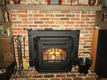

    I purchased a Mt Vernon AE Insert. When I purchased the stove, I purchased a ton of Hamer pellets.
    I live near Philadelphia in a 30 year old house that is not that well insulated. The house is 2,900 square feet but I am only trying to heat 3 rooms. The 3 rooms across the back of the house and are about 1,200 square feet.
    I have the heater turned down to 50 and it is set to the circ setting. The family room has a peak ceiling and it is where the stove is. It will get to 71 degrees with the thermostat set to 75. The kitchen is close to the same temp. The master bedroom is around 58 degrees. I can't seem to get the rooms any hotter than that. Any thought?
    The stove was installed about a week ago and I've used about 12 bags of pellets so far. This past week has been between 20 and 32 degrees. Does that sound about average usage?

    Welcome
    Just a heads up some people here will bust your nuts for not posting a pic of your stove (with fire) its a you dont have a stove until you prove it i have been there and done that

    No pic's and it never happened:)

    To late you already did! :mad:
    Welcome aboard johnny, Pay no never mind to Scott. He's high on pellets! Smells em all day and he gets a lil whacked!
    What no picture? Hmmmm, Isn't there a rule or something about dat?

    Yep... Pics or it never happened ;)

    Welcome to the Forum. Still waitin for pics :)

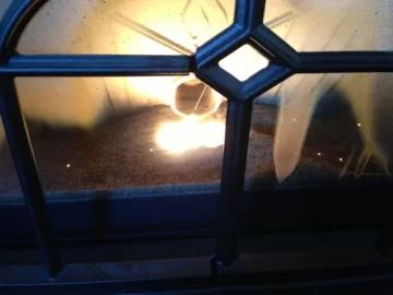

    I'm not burning hamers this year as I just found out recently they were available in my area. I'm burning green label lignetics this year...they are ok.
    I do get a good amount of ash near the fire pot, i'm attaching a picture below. You dont need to sweep it out that often, I sweep mine weekly, infact i'm due for a cleaning today. Better pellets usually equal less ash buildup, but it sounds like you are already burning premium pellets.
