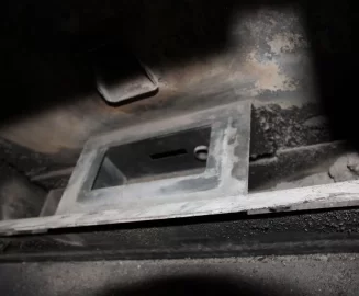

Ya did you lift up the wear plate and check under the burn pot? And make sure all the holes on the wear plate are clear so the air can get threw
I take out the burn pot, and clean under it, but not sure what a wear plate is?

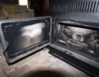

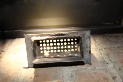

Here are some pics...
IMG_8607-800.JPG Black soot around door
IMG_8608-800.JPG Black soot after shutdown
IMG_8611-800.JPG Cleaned out burnpot and cradle
IMG_8613-800.JPG Holes are all clear in burnpot
So I fired up my woodstove (nice to have options!) and shut the PS down for a cleaning. I did a thorough cleaning and while I was at it did the monthly cleaning including opening and vacuuming out the exhaust chambers. From what I could see in the exhaust chambers it appeared less than an inch of ash. But I don't know what all was built up where I couldn’t see, but with the shop vac I think I got most all of it. Pulled the chimney cap off, it was fine, and brushed the chimney. I didn't clean it since year before last, and I don't think I used it last year (I may have fired the stove up for a week or something not sure). There was about a half cup or so of creosote. The duravent between the stove and chimney adapter had very small amount of creosote but not much to worry about (still need to get a brush for it). I also hooked up the shop vac to the duravent and that actually got a lot of the stuff out, reversed it too just to make sure it wasn’t clogged, saw dust all blowing out the front of the stove. Left the hopper lid open and fired up the stove, could feel the combustion blower blowing out the exhaust, shut it down. Cleaned out all the CR pellets from the hopper and refilled with Somerset. Put everything back together. Fired it up. Everything seemed ok, and after a bit it settled out on a 3 setting. Looks like its burning fine now. Not sure if it was the pellets, or perhaps something was clogged up in there I got out with the shop vac. After a hopper full of Sets I may switch back to the Cheats and see if the problems come back. I could hear the OAK sucking air... never paid attention to how loud it actually was, still seems a bit quite too me, but that might be in my head. I can hear it though which is good.

Yeah my glass gets coated in ash but I've not had black soot until this happened. If you see the pic with the door open the grey ash in the middle of the glass is more or less normal for me. The black soot around it is not (its also coating all the steel around the glass, door latch, etc). Since re-lite today no black soot on the glass. :cool:
Sounds like you have cleaned it and solved the problem. Could be good to go now. Like I said I am looking at buying this stove.
