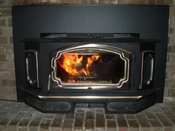

I like my Lopi FreedomBay insert. My wife likes the way it looks, and I like the heat out put. Non-cat so low maintenance.
