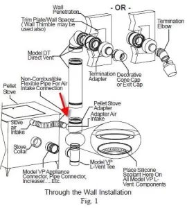

The best solution I have seen is using the SelKirk venting system that brings in the outside air thru a double wall in the pellet flue vent. This system dries out the OAK air and warms it up also. That is the way to go if possible!!!

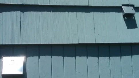

So the key to a house with no drafts is the Big 4" oil boiler OAK and little 2" pellet stove OAK in my case.
Our heating appliances are both in the basement so they would not help with cooking odors. We have an exhaust fan over the stove for that.
See Pic below of Big OAK & Little OAK !!!

+1.. I like the Selkirk Direct Temp. It's bulkier than than normal pellet pipe, but it offers great benefit in only cutting 1 hole during install, and the preheating of the incoming air: which prevents the condensation drip off which happens with most fresh air pipes during cold weather. The 4" dia vent is easier to clean, as well.
