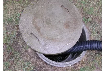

Posting a pic of the lid would be helpful : )
heres the lid. By the way, whats the easiest way to post a pic-the quickest

You could rig up a buzzer alert to sound when your cistern is full. Being close to the house,
you could drill a small hole in the neck of the tank (just under the lid) and bury the wires and
run them into the house for the buzzer. Make (or buy) a bracket to hold the float switch near the
bottom of the neck of your tank. Change the battery when you change the ones
in your smoke detectors. Cost: 25 or 35 bucks : )

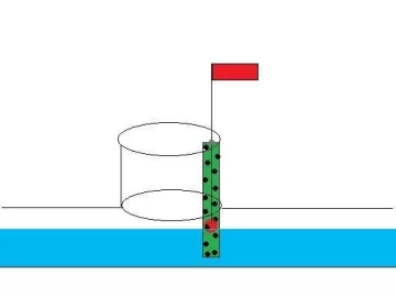

Ok, a float on a stick inside a length of perforated drain pipe and a hole in the lid : )

how do you make those drawings?
Ive considered that idea, but again don't really want a long pole sticking out all the time.
Use that same consept but if that "stick" could bend right back down into the tank, and have it marked on the stick/wire/something.
Pook, I like it. You think I could rig an old tape measure in place of the string? It may need to be inside a piece of PVC. I suppose the tape would rust.
