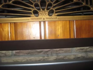

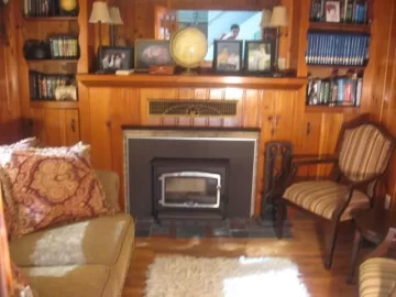

    The picture of my wood burning insert in my avatar is an Osburn 2000 wood insert installed in a Superior Heatform metal firebox. My chimney is clay tiled lined and brick. You can do it just have it professonally inspected. We also had to cut out those round tubes for the stainless steel liner to hook up to the insert. Make sure and it will be hard this year to have seasoned wood and that means wood split and stacked for over a year (oak 2-3 years), you and your insert will be happier. Sorry for the duplicate pictures my computer didnt show they downloaded to the site.

    Thanks for the pics and the info! I esp like the cover for the venting area.

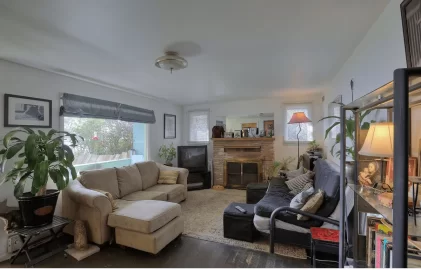

    Here's a picture, sorry it's not very good, this is the listing photo, so not our furniture or anything.
    well not sure if this is the right size, we'll see
