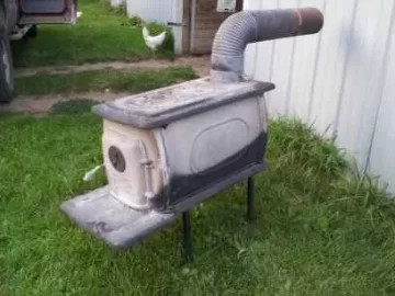

  22. jeff_t Minister of Fire
    joined: Sep 14, 2008
    2,718 posts
    SE MI
    BrowningBAR likes this.

    So it ran away, is that why its white?
  24. jeff_t Minister of Fire
    2,718 posts
    SE MI
    They aren't known for being airtight, or any sort of controllable. There is also some argument about cheap Chinese paint. I definitely would not put one in my home.
    That pic is from a local craigslist. The guy was trying to sell it for $250, with some pipe and a heat shield.
