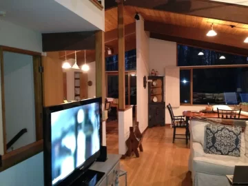

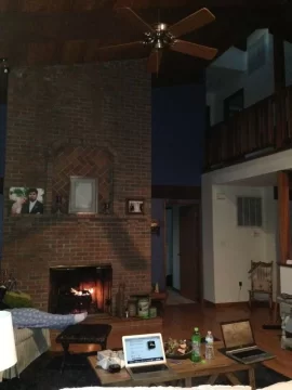

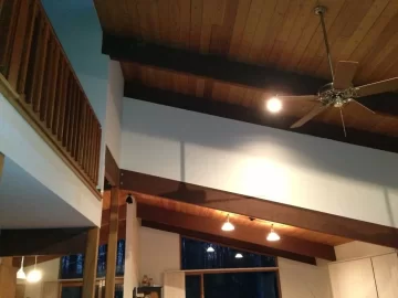

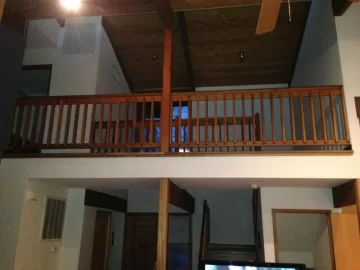

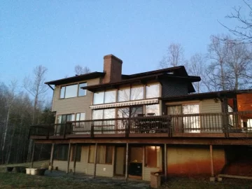

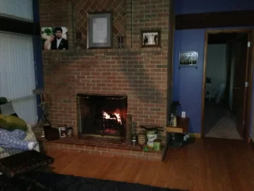

    A little background first: Our home is 2800 sq. ft with 1800 on the top two floors. Our fireplace is in the center of the house with the large portion of the main floor being open.(LR/DR/Kitchen) The master bedroom is on the main floor as well so much of the actual living we do is on the first floor. The ceilings are cedars timbers with 1" foam insulation and the entire back of the house is windows. The ceilings are about 16' above the fireplace hearth and 24' adjacent to it in the stairwell/foyer.
    I have included pics to try and give you an idea of the space.

    1. Shows better in the fireplace opening.(about 5" all the way around w/short leg kit)

    I would opt for the Firelight. With the high ceilings you won't get overheated in this space. A ceiling fan running in reverse will help break up heat stratification.

    You are trying to heat an uninsulated glass house of almost 4,000 sq. feet. There is not a wood stove made that is going to do it on the coldest nights. A BK Princess might work most of the time. The Jotul F600 will work a good deal of the time. The Oslo will provide a pleasing warmth on those cool days in the fall and spring.
    The first money I spent on your house would be on trying to provide some insulation on the windows. I don't know with what - cellular shades, quilted shades, simply framing in some of them, something. You simply will not be able to provide enough heat from any point source (stove) to keep from being chilled close to all that glass. Then I'd tackle the ceiling - one inch of foam? One INCH? That is r-5 or r-6! You need r-40 or better.

    My preference would be to have the block off plate lower at the lintel level rather than have heat collect up in the damper area. In the least I would have them pack Roxul around the damper plate and pipe and at the top.
