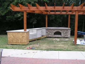

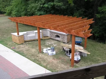

built the pergola last year, 2x12 rough sawn rafters, 6x6 posts 10 foot tall 32x16 trapezoid. put the outdoor kitchen foundation in 2 weeks ago. poured concrete tops last week and stoned the front this weekend. the remaining exposed concrete is going to be stucco. the back is going to be cedar siding to match the pergola.size perspective, the pizza oven slab is 6 inch thick and 9 feet across the front.
