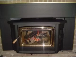

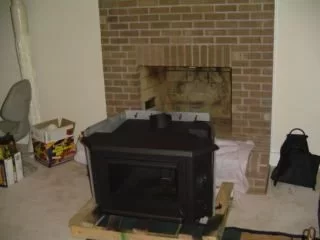

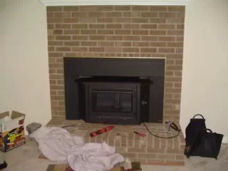

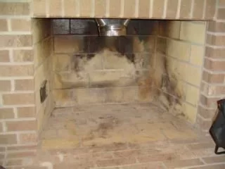

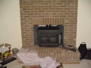

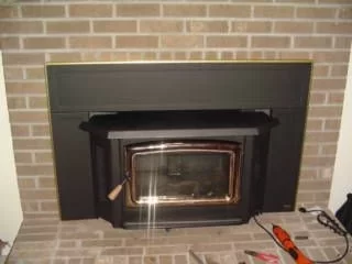

These pics are from the PE Summit install my cousin and I did back in Feb. Pics include, open masory fireplace, insert, direct connect kit installed, misc. tools, surround and trim, fire burning and maybe the pallet the insert was on. I will have to run the extension cord under the surround on the right side, but I will hold off on that until it gets warm (stove down time) To date, this insert heats most of my 3000 sq. home.

Most of the month of Feb. had been mostly cold. Mostly all the way up to the last week of March. The 6-8 hour burn, the secondary burning that looks like a gas stove burning at the top of the firebox, excellent view of the fire thru the glass door and the HEAT. The oil truck hasn't been by, so it was a very good investment.. I've viewed your install pics months ago, which actually answered some questions I had on my end..

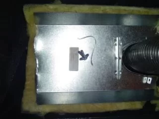

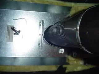

CK 1, Getting ready to install my new Pacific Summit Insert. After looking at your most helpful photo's I noticed a difference in the top venting flu that your stove has. Mine came delivered with a flush mounted 6" flu. Did you add an adapter or was your 6" flu exhaust integral to the stove? Thanks New PE Owner and new to the woodstove game.
I just installed my PE insert this past weekend, I used an adapter to connect the insert to the 6" flex liner.
Thanks Ray PA, correct me if I am wrong but was your PE insert's exit flu flush with the top of the sheet metal (silver) surround of the stove?? Tks again.
yes, the adapter sildes down into the insert 'exhaust hole', I should have taken a photo of that, but I didnt.
