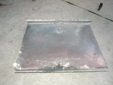

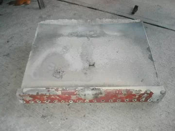

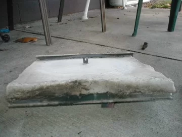

Ok photos in order:
1. Baffle front with insulation on top and shield over the insulation.
2. Baffle rear view, w/ insulation shield off and showing insulation on top of baffle.
3. Baffle with insulation and shield removed off the top.
4. Baffle with insulation on top, and the shield that sits over the insulation removed and sitting next to top insulated baffle.
This is how my 2006 Summit insert is set up.
Not sure how the new ones, or T series are set up, just figured they would be the same.
madison said:
Hog, that is exactly the same, I must of misunderstood. There is a layer of insulation between the top and bottom pieces of the baffle assembly
Ok sounds like terminology conflict.
The baffle, is a closed hollow box with the holes in front & bottom, and the rectangular opening in the back that rests over the air vertical channel at the back of the stove.
The insulation lays on top outer surface of the baffle. Then a heat shield which is basically a flat pc of s.s. with the sides bent down. The shield just lays on top of the insulation and the two tabs are bent over to hold the shield and insulation on top of the baffle. I maybe misunderstood BG, and thought he was thinking the insulation was inside thew baffle itself, which is just a hollow box basically.
I have had the baffle out, (well gets done every year for sweeping), took the top shield off, the insulation off, the side rails & insulation out, the stove top inner heat shield off. Even took the EBT off, thats when I found the shutter inside out of place and inoperable letting air flow constantly. Gotten real familiar with the stove.
