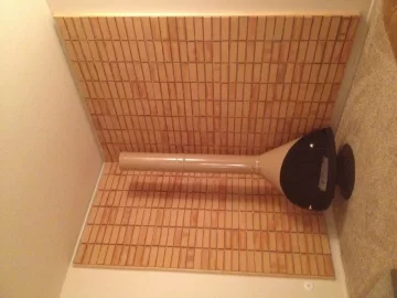

    Hi folks! Just about to prime and paint my newly installed thin brick surround on cement board and it struck me...I better make sure it's OK with NFPA 211 (reduced clearences and non-combustible walls) before I lay this paint down. Pretty sure I am good, but wanted to check with the fellow hobiest and experts.
    For reference, I have a 1" air gap behind the cement board. Thin bricks layed down with modified thinset. Going to use a latex primer and Valspar gloss latex as top coat.
    Many thanks to those that can please chime in.
    Thanks,

    Thanks for all the feedback thus far! These thin bricks were picked up at a recycle store for twelve cents a piece, I think lowes has them for special order at over a buck each as I recall.
    We went with a straight pattern for a mid century modern feel. The malm fireplace will be located in the corner slightly offset to meet the clearance requirements. Attached is a pic showing the malm in front. Also my next step is to custom form a concrete raised hearth.

    Haha my wife is the interior decorator and I just put in the grunt work :). I have a the latex already bought and just waiting for a warm and fuzzy that latex won't deem my wall "combustible". I also shot a note to the city inspector but I'm sure he won't get back till tomorrow.
    I have seen so may painted brick fireplaces but this being a freestanding, the rules could be different?

    Well, personally, I wouldn't paint it at all. I think it looks good as is. And I like the pattern . But, I believe that latex paint is not considered combustible. It may discolor or blister, though, if too hot.
    Oh, and is the air gap open all around?

    Thanks guys, yea I like the way it looks too and could go either way. And yes there is air gap all the way around but i trimmed off the sides as the nfta 211 says that if the walls are in a corner, only the top and bottom need to be vented.

    Just got word back from the city inspector and I quote-
    "Paint would not deem the wall “combustible”. Paint away."
    Needless to say I feel much better and glad I held off until official word came back. I am going to try and track down the flame retardant paint (oil base if they have it) and get to painting. Will post an updated pic once complete. Thanks all!
