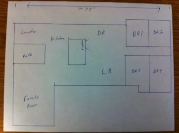

1, I like the Summit better for the larger firebox and longer run times. My house listed as 2500 sq ft but did an actuall living space calculation of ~ 1800 sq ft.
Will the Summit be too much stove for the space? The fireplace is perfectly located in the center. I will attach rough drawing.
