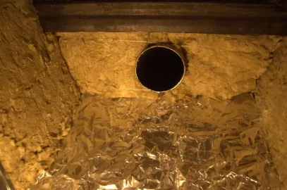

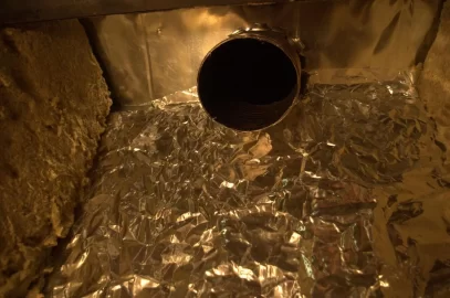

Ok, is it an insert or free standing stove. I thought you corrected and said it was a free standing. Only the insert has a "shroud". And you should not be insulating around the stove or insert itself. I suppose it would be fine to insulate the old fireplace inner walls. You should install a block off plate where the liner goes through the old fireplace damper(if you have not already done so). this keeps the heat from going up and getting absorbed by the masonry chimney, and being released to the outside. You can roxul the top of the block of plate if you want. Insulating around either the stove or insert, whichever it is, will only keep the heat inside the stove, rather the release it out to the home.

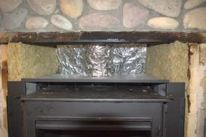

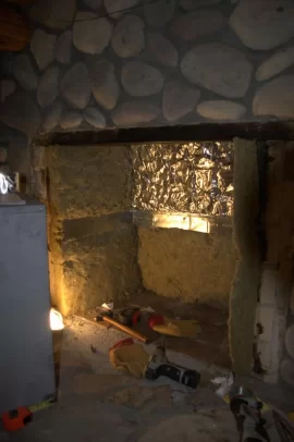

Ah... sorry for the confusion. Yes, this is the insert, not free-standing. Like I said, I talked with PE tech support and they said that while it's not OK to insulate the shroud directly, it is OK to insulate the fireplace box. My installation was a little tight, so I had to get creative with the attachment of the Roxul to the wall to make sure it stayed on the wall, not on the stove. I added insulation to the thickness necessary to keep the "fireplace" dimensions to what the install manual said. Something like 1/4" gap around the shroud IIRC.

I'd hate to see this firebox insulation bite you later on if there is an issue.Did you get a signed copy from the tech with his name clearly visible on the statement? If so, send a copy to the dealer to have on file. It should work fine, but watch for overfiring.

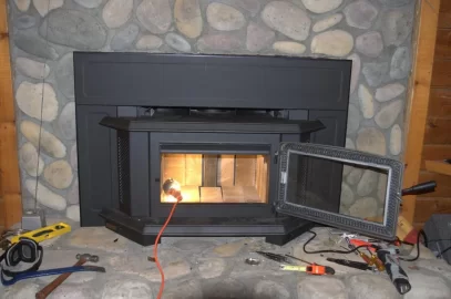

Nice stonework.
Is that a prefab fireplace the Summit sits in? No wood or other combustibles behind?
Nice stonework.
Thanks. The fireplace is a built-in-place masonry with firebricks behind where I put the Roxul. I don't think it was ever fired as a fireplace, as it had an insert (slammer) in it when we bought the house. The whole masonry faux-stone (they're actually cement... flat on the backside) structure is external to the house and goes up to the exterior chimney. The inside face of that is flush with the wall and what you see. Thus the desire to insulate it so the exterior masonry doesn't suck the heat outside. Unfortunately, that foil-backed area directly above the stove is only 1/2" thick since that's all the space there is.
