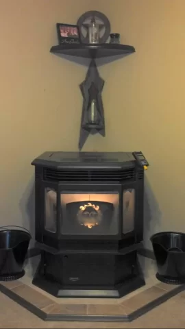

I measure convection air temps with a K-type thermocouple. Can be had cheap on Amazon for $25-$175. I got my Cole Parmer for $30.
I only do this for my own testing. To rate one pellet to another. Not a must have. But I try to buy pellets when they are cheaper and knowing what a good pellet is, ensures that when they go on sale, that I snag them up. Somersets, Pro Pellets, and Lig Prest-Logs are the 3 hottest around me (not many brands).
You can use a meat thermometer, a digital cooking probe, or search k-type thermocouple on Amazon. They can be had for cheap. Just make surr whatever you ise. That it doesnt touch steel. You want to measure the air temp. Not the steel temp.
You can see it on the right side (top of stove) above the glass
