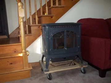

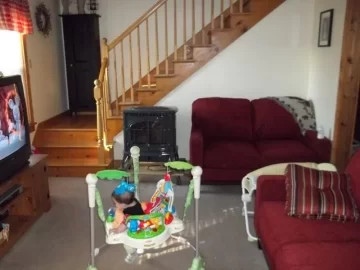

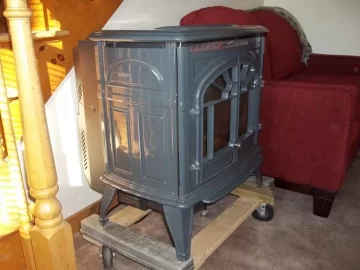

I just figured I'd drop by and ask the experts who don't venture out of the Hearth Room. Just got this Enviro Windsor stove and would like to ask the experts some questions about outside air intake pipe, can I use 2" EMT? The stove calls for 2" ID and it fits the description. Also worried about the proximity to a sofa (8") and the 5'2" horizontal run from the rear of the stove to the outside. Please check out my thread from the Pellet Mill for the pics of the stove and location.
