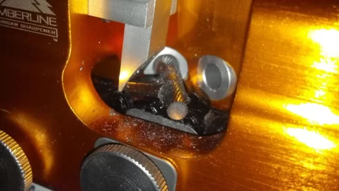

    I have the Timberline that MasterMech recommended. I also have the Stihl kit that Smokin recommended. And.... I also have the Husqvarna sharpener that does both the Cutter and depth (raker). My BIL has the PFERD system..
    To go back to factory conditions. The Timberline system is hard to beat. Takes the same amout of each cutter. Same angle.... Great edge.
    But for speed. The Timberline isnt gonna cut it. In the Field. I use the Stihl Sharpener system.. I only use the File now (without guide) and find it to be the quickest. I get better every time.
    As for my Husqvarna sharpener. It takes to much off the rakers (if you have to keep hittin the cutters). The PFERD feels better in your hand and my BIL Loves his. Only uses it.
    Everyone has there own likes and specifics. It took me several different trys to find what I like best. Between tank fills, its the hand file. On the weekend or after a good couple days of cutting. I bring the saws inside and hit with the Timberline.
    To each there own. That PFERD has its own following. Different strokes for different folks ;) (here is a close up of the Timberline)
