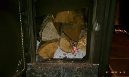

  4. Highbeam Minister of Fire
    This was the load. As soon as possible without snuffing the fire, the air would be shut off to zero. Then, as with all non-cats, you lose any ability to control the amount of flames or the stove temp as the outgassing wood provides fuel to the firebox over the next several hours. In the morning, stir the coals and find enough to restart.
    Stove is my previous heritage and the wood is hardwood technically but our hardwoods are relatively soft.

    You must have a really strong draft if you can shut the air down to zero and not be smoldering your non-cat! If I cut the air down that far, I lose my secondaries pretty quick. If I leave it shut down at zero overnight, I'll wake up to soot black glass on the front window of the stove.
    For many people, my first thought would be that there was a leak in the stove somewhere that was impacting the ability to control the burn even with the air shut all the way back. I replaced my door gasket to improve the seal when I was experiencing trouble controlling the burn. I doubt that is the case for Highbeam though, due to the amount of experience he has with wood heat.

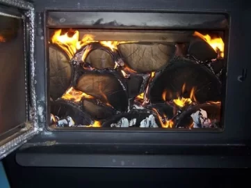

    Managed to stoke a fire from coals this morning after last night's burn :)
    Bout 39 deg tonight, here's the load, coals were raked to the front, couple bigger splits at the back, 2 slightly smaller ones in front of that and a small one on the coal bed. Fired right up, got to about 650 before it started cooling down. Worked air down to 1/4 open, sitting at about 500 stovetop right now.
    [IMG]
    Only thing is.... grabbed a flashlight to check the chimney, can see (and smell) some smoke coming out. From my extremely limited burning experience (one week), once I get up to temp, I usually can't see anything coming out of the chimney.
    Am I causing a big layer of creosote in my chimney by turning the air down so low for these overnight burns? Left it pretty much the same last night but didn't check the chimney.... had a small quarter sized mark of black on my glass this morning.....

  13. Highbeam Minister of Fire
    Like that since it was new. Of course, with modern EPA non-cats shutting the air control to zero is absolutely not the same as shutting off all air going into the stove. They all have leaks built into the system.
    My chimney is ideal for a non-cat though. Meets the minimum height with zero bends and all internal double wall. Also good wood of the proper split size.
    You can't just shut it down right away, you have to do it at a rate that maintains a flame. Always woke up to clean glass and a handful of coals within white ash.
