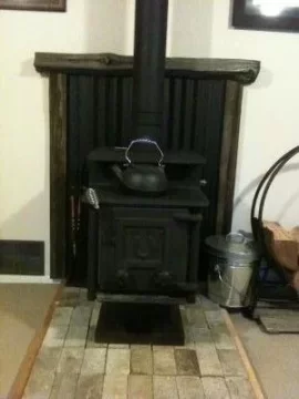

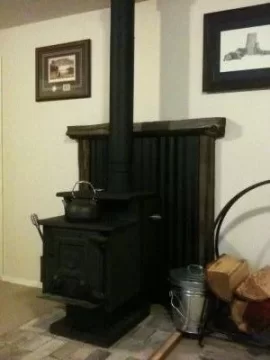

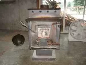

Pic #1- I purchased a used Englander 24 AC from Craigslist and refurbished it- new paint (rustoleum high heat in black)/combustor/impingent plate/new carriage bolts (Cutting the spot welds was a pain but the dremel worked nicely)/door and flue collar gaskets. I purchased a factory heat shield for 6 inch clearance but gave myself 9 inches anyway so that I could add some heat protection for the wall anyway. The blower on the back of the stove gave me 4 inches of clearance from the wall.

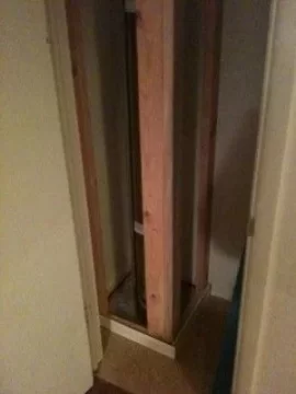

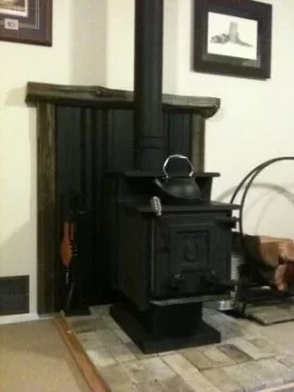

Pic#2- The chase (open)- The picture only shows the frame. I ran in a closet and was able to save most of the closet space. Currently, it needs to be finished with mud and tape.

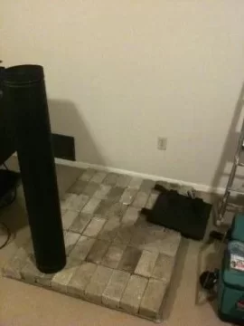

Pic #3- the simple hearth made of patio bricks and wood from the barn. I plan to replace this later this summer with a nicer hearth of rock or old red brick to raise it a bit higher and make it nicer. THe floor hearth was put together quickly to facilitate getting the stove in.

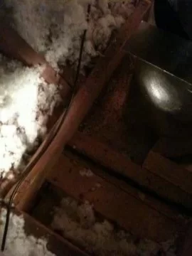

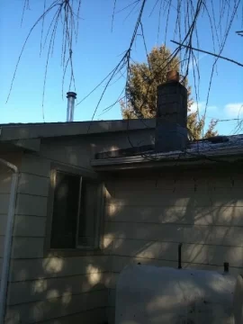

Pic #4- the ceiling joist was cut and a header applied.
