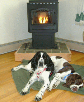

  20. lessoil Minister of Fire
    joined: May 31, 2008
    659 posts
    Western Maine
    Glad to hear things are working out.
    After I put the tape on the exhaust pipe, the smell of smoke was gone.
    The "new" smell of the stove went away after a few days.
    We are getting condensation on our air intake pipe. I will have to insulate it.
    This first year is a learning experience for sure!
    The other night I thought we had enough pellets to last the night.....I was wrong.
    It was 63 downstairs when I got up. Oh well did a quick clean,added pellets and fired it back up.
    We sure are enjoying the heat as are our two babies!
