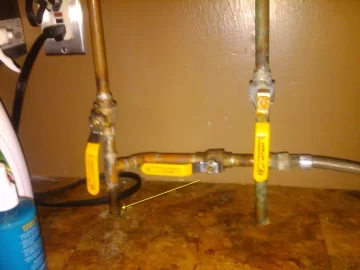

    The best place to install the unit may be under the floor in the garage space on the hot water line coming up to the sink and dish washer. See yellow arrow in 2nd pic.

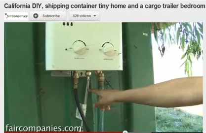

    It is used in this DIY cargo trailer home for all their Hot Water!
    http://www.youtube.com/watch?NR=1&v=DsVxgOjNLbA

    Don, it is for outdoor use only due to the venting of the unit. Products of combustion to remain outside.

    Yes, the woman in the video has it mounted on the outside of her cargo container home but it is hooked up to her kitchen faucet! It must be a ventless LP gas heater.
    I actually like the quick easy install. It looks like the woman just unscrewed the shower head and screwed in the kitchen faucet! ! !
    Not sure where she lives but any outdoor temps below freezing would effect this type of install!
    That would be a real concern up here in NE !

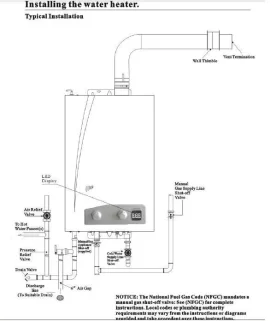

    So what I was thinking, that since the kitchen is far away from the DHW Tank and close to the propane tank, it may be more efficient to heat the hot water for the dish washer and the kitchen sink with the liquid propane tank? Installing in the garage space has plenty of ventilation and never gets really cold!
    Maybe this one would be better? However install is tougher, all the standard plumbing.
    Going this route it would make more sense to put in the basement and use it for all DHW.
    http://www.basspro.com/Eccotemp-L10...9705&SST=34647cbc-dce6-5828-e37c-000032b44f04
