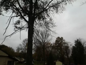

So far....

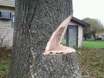

Going to make the notch a bit bigger...

Your notch was more than big enough, were you tied off with bullrope or steel cable? Did you use wedges as a failsafe? If the tree doesn't have a favorable lean, we usually use wedges as a failsafe. We did a medium sized spruce and a big ash tree today (around 28" diameter at the base), I had to climb and top some of it first as it was pretty close to the house. Lots of good firewood there, WS. Some pics of the aftermath and of the splitting when you get a chance, maybe?;)

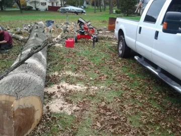

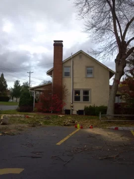

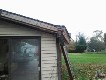

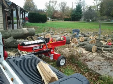

Tree felled, almost where we wanted it. One of the branches unfortunately clipped the very end of the porch, w/o any structural damage.The tree rolled a bit. My buddy was actually pleased because it exposed some pretty rotten roofing. Damage was to the gutters and soffit. We did rope it, and had to use a pulley. Overall everything went well. We were only able to finish up the crown, and will finish another day. 2 pickups, a trailer, most split and stacked. 2+ cords easy done, around 3 cords to finish up. Was a beautiful tree, buddy wanted it down, offered me the wood.

FWIW; the hing looks thin to me, might be why it rolled

So how did you get the wagon?
Dennis, that was my buddy's wagon there on his property, maybe kinda hard to see behind the splitter. The shovel inside it was fine, as was the wooden post with the electrical outlet. Crazy!
