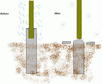

    This reminds me of a problem I experienced from the previous homeowners. They put pouring tubes in the ground, put wooden 4x4 support posts into the tubes and poured the cement around these wooden supports so they were encased into the cement. I'm sure they were thinking saves them from having to go through the work & cost of anchor plates & threaded rod plus saves concrete. That technique is actually advertised and allowed for support structures, I think it shouldn't.
    Anyway when the pour happened the wood posts absorbed the water from the cement and expanded, the cement set, the posts dried and shrunk leaving a gap all the way around them which filled with water when it rained, winter came it froze and blew apart the cement around the support posts leaving them bare and nothing to prevent shifting. I included a picture of what I'm talking about that happened to all the footers of the supports of my back porch.
    So, the technique is good for a fence since it's not a support structure and if it splits the cement, not like it has anywhere to go. But, figured I'd show the problem this technique can cause for anyone thinking of adding a support structure and using this approach, which unfortunately is often stated as an option.
