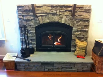

We have been having a house built and should be moving in at the end of the month. We had our 1950's rambler knocked down and reused the lot since we love the location and a large remodel was not too far off of a knockdown/rebuild. When designing it, I insisted on a wood burning fireplace instead of the gas one offered. I know too many people that have gas fireplaces that are used for a month and almost never again after the first utility bill comes in. My sister cringes every time one of the kids flips their fireplace on.

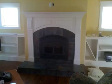

My wife was pretty good about humoring me and let me select the fireplace as long as it had a high WAF. I settled on a Quadrafire 7100 for our 3,000 sf house. It has two levels and is very open so I have high hopes that the 7100 will help defray my winter heating bills.

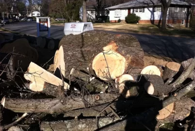

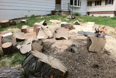

I have a fair amount of wood since I did all of the site work on the lot last fall with the exception of a big silver maple that was in the front near the power lines. Since I wanted the wood and brush for mulch, I had the arborist leave everything so I could process it later. The main part of the trunk he left was 6' long by 36"-40" in diameter. It took a bit of work, but I got it cut up. I kept all the trees and have it c/s/s along the back property line. (I even dropped a big tree on the house once we had moved out just because I could. It was a big tree, but the little house was tough. The tree just creased the eaves.)
