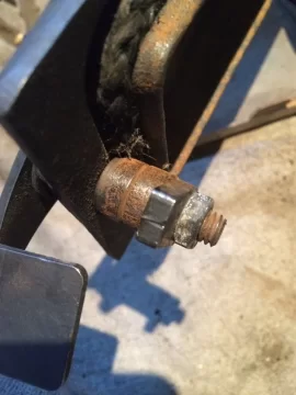

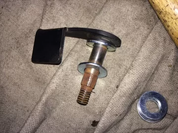

Quadra Fire Castile Ash Door was not latching. Anyone else see this problem?

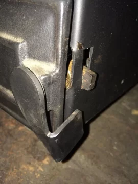

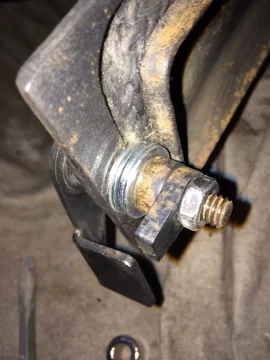

So I took out one of the OEM spacers and added 3 washers.
See pics
Pic 1 & 2 - Shows OEM latch
Pic 3 - Take off washers
Pic 4 - 3 New washers

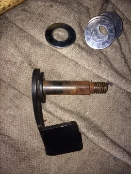

Pic 5 - Fixed!
