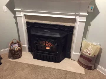

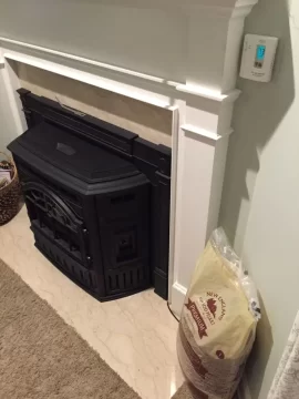

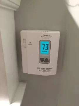

Two days after I called Dave at Mt. Tom's Energy, I receive my new wired thermostat. Dave gave me two options: The Quadrafire wired stat and Daves optional stat. I got to ask why o why would quad supply a stat with only a +\- 1 degree differential. The stove would go on and off like crazy stressing out the igniter. Dave's option gave me the a +\- 5 degree differential. While it is a very simple plain Jane thermostat, I couldn't be happier. I removed the old wireless thermostat receiver and installed and wired up the new one. My wireless saga has ended :)!!!
