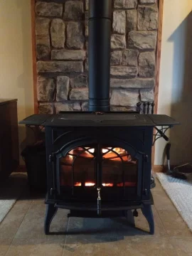

Quadrafire Isle Royale installed!!
Trilifter7 Posted By Trilifter7, Mar 24, 2013 at 8:32 PM
  1. dafattkidd
    dafattkidd
    Dec 11, 2007
    1,733
    332
    Long Island
    Looks great. The Isle Royale is a beautiful stove. My friend, who happens to be another member on the forum, has one in porcelain white. It's beautiful, and throws some heat.

  4. northwinds
    northwinds
    Jul 9, 2006
    1,452
    236
    south central WI
    Looks like a showroom pic, and the showroom is in your house. :)

  5. teutonicking
    teutonicking
    Feeling the Heat 2.
    Aug 18, 2011
    387
    268
    Maryland
    She's a beauty. The IR was on my short list of stoves in 2011. I ended up with the Progress Hybrid, but I really like yours too. Enjoy!

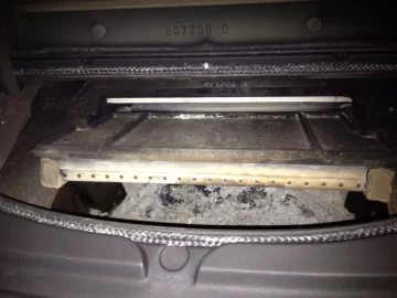

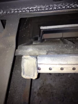

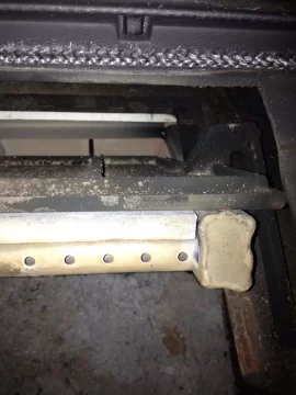

  16. Trilifter7
    Trilifter7
    Feeling the Heat 2.
    Oct 19, 2012
    452
    258
    Beavercreek Ohio
    I did have one issue with this stove that the dealer is taking care of. Every time I would rotate my top burners vertical the fireboard baffle would slide down about an inch or two below the top plate. Then when I'd rotate it up it would hit and push the small back baffle up allowing a gap between the two baffles. I had to reach down in with the burners vertical again and push the baffle piece back up in to place to get it to close right. This was not fun when the stove and burners were hot!!! I told my dealer about it so he came out and took pics to send to Quadrafire. After looking at it we concluded the problem was the welds on each end of the bars that the burners go into. The welds were pretty sloppy and over filled which caused the top plate to not be able to bolt flush to it. Since the top piece was raised off the burner rails that left the gap allowing the fireboard baffle to slide around. After seeing the pics Quad approved the replacement and ordered me a new top piece and burner assembly to be replaced under warranty. Glad I decided to install this now instead of waiting until next season! Also good to know I have a dealer willing to help me out and work with me. Should have the new pieces installed in a few weeks. image.jpg image.jpg image.jpg
