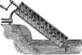

In the beginning of this season I ran into some 8 mm pellets with too many fines... the feeding system simply quitted and the fire went out. I had to empty the hopper and vacuum the fines out of the hopper. Now, the fines never blocked the rotation of augerscrew, but the feeding system in my Whitfield Quest Plus is not able to transport saw dust, since it's based on the ancient Archimedes screw principle invented by Archimedes in Greece ca. 300 B.C. Photo below.
Pellet stoves with a horizontal auger, however, may be able to tranport the fines... I don't know. As far as I know the Harman stoves have a horizontal screw auger, so perhaps they can do the trick ;-)
The only "harm" the fines did to my stove was stopping the fuel feed (and eventually the fire)... they never blocked the rotation of the auger and I believe this is mainly due to a significant difference between the ancient screw on the photo and the one in my pellet stove... in order to transport water there's very little clearance between the screw and the cylinder.
For safety reasons and to avoid blocking there's a bigger clearance between screw and tube in the pellet stove. Also, the tube is not cylindrical but octogonal, thus creating some channels where stubborn/long pellets may be pushed aside on their way up to the chute.

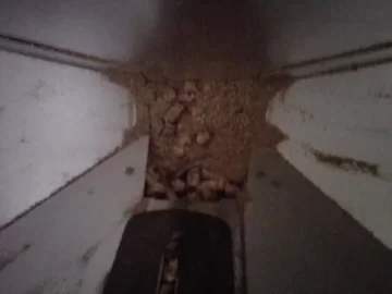

DobieMom, the auger on your Quad, is not a solid auger. It resembles more of a spring. I just dump everything from the bags in. When I do my bi-weekly cleaning (or monthly if u pefer), I normally let the stove run out, or close to running out. Shut stove down, get what pellets you can out with a cup, hand, etc. Then just vacuum out the entire hopper.you still have to worry about fines. Its just not a screw to cylinder clearance issue. Its a build-up issue. The fines will build-up and not allow the pellets to move up the auger. Especially if you have your fuel gate (rod) closed most of the way. Its not the most heavy duty system out there, but I have been burning AWF's that are on average 2", with a lot of them pushing 3" long. Eats them just fine. The somersets I've been burning, have about a hanful or better in each bag. Pic below is about a months worth.

I sift all mine, gives me something to do in the winter. When your fire gets smaller time to empty hopper and clean out the fines, they leave no room for pellets.
Burned almost 1 ton, never cleaned hopper. In your owners manual Quad recommends cleaning fines from hopper every so often.

When your fire gets smaller time to empty hopper and clean out the fines, they leave no room for pellets..
Definitely true, fire will be much larger, when there is room for the pellets. Fines take up a lot of the space at the bottom. Doesn't take much time at all.
