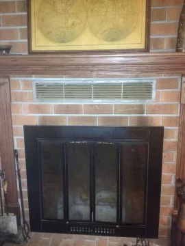

    Wound up having to pay a visit to someone across the street from the stove shop, so I dragged Mrs. Blue shopping.
    Stove guy tried very hard to sell us a prefab fireplace he had on the floor. Mrs. Blue explained that I spend quite enough time messing with the stove I have and that she was in no mood for more wood burning hardware. Then her eye fell on various fireplace door assemblies that admittedly would look better in our living room (Brand was Stoll, I think.) Conversation then turned to the fact that we'd really rather be rid of our monstrous brick hearth (pictured) and that we are considering cladding over it with drywall, similar to some display hearths they had on the floor.
    Anyhow, he insisted that we could face over the hearth brick by:
    1) Removing the pictured heat exchanger grate
    2) Stuffing the opening with Roxul
    3) Having a mason brick up the opening
    4) Screw furring strips to the brick
    5) Attach cement board or drywall to furring strips and paint
    I know I've asked this here before, and the consensus seemed to be, "Don't do that."
    Is this fellow wrong?

    You are right, don't do that. He blew it when he added the furring strips. They are combustible as is drywall. That isn't a bad looking brick fireplace. Maybe just tile the area framed by the mantel instead?

    The room in question is rectangular, 28'x14', with the fireplace centered on one long wall. The hearth pictured is about 10' wide total.
    The problem is that the hearth is floor-to-ceiling brick, so it dominates the entire room. Further, that heat exchanger grate is... ugly.
    Burning in this fireplace is for ambience only- the 30 heats the house. Further, we expect to be moving within 2 years, so a full-bore masonry-demolition project is out of the question. We are hoping to keep the fireplace usable, but to minimize the domination of the brick.

    If an insert is put in the fireplace then I would I would be much more comfortable with it being blocked off.
    I'm hesitant to recommend closing off the heatilator vent in the fireplace. Is the vent is connected to a heat exchanger up at the top of the fireplace smoke chamber? If so, where is that heat going to go when blocked?
    Can you find the make and model of the fireplace? Look for a small tag near the bottom.

    The heat exchanger is built into the masonry- it does not appear to be a stand-alone unit.

    Look up in the smoke bell for heat exchanger ducting. Pull the grille and see if there is a metal box behind it or all masonry.

    If you're leaving in 2 years or less, why bother doing anything? Perhaps to increase resale?
    That's a crapshoot.
    I wouldn't touch it.

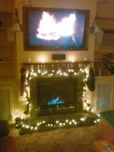

    I got a DV LP Heat & Glo and built in the Flat Screen.
    Now I just run the DVD of the wood fire and it also has xmass songs too!

    Cultured stone is doable over the brick, nail metal lathe, mortar on the stone.... Depending on the area, some of the stone is affordable.
  16. Hogwildz Minister of Fire
    Just painting that grate a nice flat black would do wonders. I myself, if that would not do.... would go to Home Depot, they have a small bin full of different styles of metal panels with different holes & cut out styles. I used a clover style metal screen and painted it oil rubbed bronze. I will be installing it on small openings in sides of the back of the old chimney which is now in my new bedroom to be. I get minor free heat from the masonry and made 2 high openings and two low, and they do convect. You could even cut the louvers out of the old frame and reuse the frame around the new grating. paint it any color you want.

    Do this! Esp if you are leaving in a couple yrs. And then put some other decor around.
