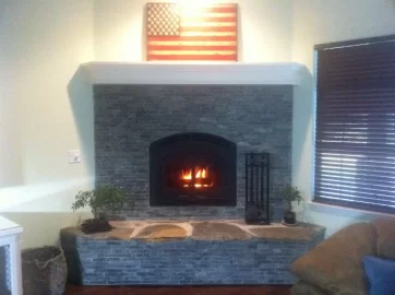

    Finally got a picture uploaded.
    Thanks for the help, I split what I figure to be about 5-6 cords of wood this last week. Not sure what to ecpect to use through the winter but I hope I will be ready. Actually I hope I dont use more then half so that I can have some better fuel for next season.
    Thanks again.

  10. begreen Super Moderator
    joined: Nov 18, 2005
    36,118 posts
    South Puget Sound, WA
    The fireplace looks great. Nice installation.
    Almost for certain the wood is the issue. It should have been split a year ago or at least in the spring if it was standing dead wood. If oak it should have been split a couple years ago. Get yourself a moisture meter to learn when the wood is dry enough to burn. Resplit a split of wood and test the freshly exposed surface of the wood. Ideally it will be in the 20% range.

  12. dafattkidd Minister of Fire
    joined: Dec 11, 2007
    1,136 posts
    Long Island, NY
    Great install and beautiful unit. Welcome to the forum. For this year maybe consider purchasing biobricks or some sort of compressed logs to substitute for not so seasoned wood.
