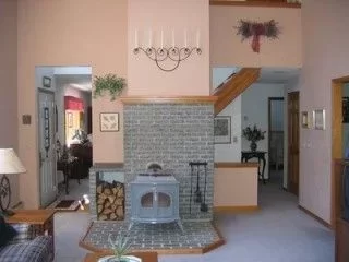

    Please excuse my ignorance - what is DT? It sounds like the OAK is a good thing to do but I think the only feasible way is to somehow utilize my chimney. The stove will sit in the center of the house, in the center of the family room. There are walk ways on either side of the hearth and we have a basement so I can't go through a crawl space. However, the basement is not completely finished so I might be able to drill through the brick hearth and through the sub-flooring to get to an exterior wall. Seems like a big project though...

    Here's a picture of the current set-up with the wood stove. Again, I'd like to swap out the Vigilant for the P68 and vent it right into the chimney just like the wood stove is currently.

    Thanks. That was really helpful. However, I don't really want to run this straight up adjacent to my chimney and through the ceiling. Do they have an elbow adapter so that I can vent it into and then up through my existing chimney?
