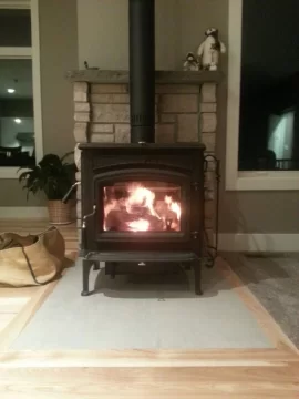

    Glad to see this thread - I wanted to post this this morning: So how hot have you guys been able to get your Rangely? I have been putting the thermometer on the top load plate - the hottest I have ever been able to get it is 650. Running it "hard" I can maintain 500-550, but that is about it. And this is with the thermometer on the top plate - some of you are getting 650 with the thermometer on the side? If so, then I think you are able to get more heat from yours.
    A couple thoughts - I have the OAK on mine, does anyone else? While giving a nice air feed, I am feeding the stove with colder air. I have always wondered if this could be a factor?
    As for our chimney - it is tall. Runs enclosed through the second floor and then through a chase - total length about 20-ft. But with that, our draft sometimes bothers me. If I try to add another log after recently loading it (before it really gets going) it will spill a fair amount of smoke......anyone else have this?
    Don't get me wrong - it burns very well, and does a good job heating almost 3,000 sf. I just question it a bit........here's a pic of the install......
