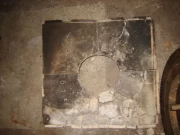

I have an old Supra woodstove, originally manufactured in Obernai, France. Three of the four firebricks at the back of the stove are cracked and broken, some into fairly small pieces. I'd like to try replacing them with some regular firebrick that I will cut to fit but I don't want to create a monster that will burn somebody's house down.

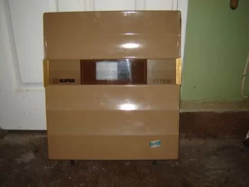

This stove has quarter inch thick panels at the top and sides but the front and back are only sheet metal with fitted bricks inside. There is a small viewing window on the front of the stove and the bricks are still quite good. It's the bricks around the stove exit pipe that are pretty badly crumbled.
I plan to cut regular three dollar bricks to the right size using the original as a pattern. Do I need to mortar the bricks in or should I just cut them as accurately as I can and ensure a fairly tight fit. Is an eighth of an inch play too much to allow? I will try for tighter but I'd like to get an idea of just how much space I can allow between the bricks without creating a hazard.
