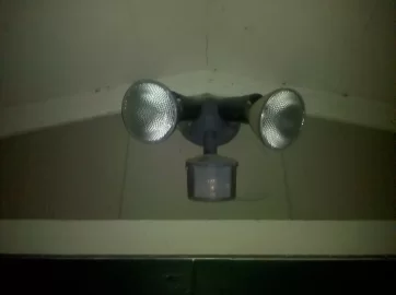

    Jake, I have one on my yard/wood shed that has been working flawlessly for 10 years. I bought it at the local hardware store. I will look but I don't think there is a brand name on it that is still visible. I love it though. Turns on every time I go out to get wood. ;)
    Edit: Found the brand "Regent Lighting Corporation" It is a 2 socket (for 75 or 150 watt flood bulbs) and a motion/light sensor in the middle. Oh, had to use the ole Bangor Maine FD flashlight to read the brand name on it ;) )

    Here is a pic of it
