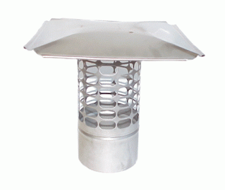

    So I have all the burn tubes, baffles and baffle plates out. With my head in the box I can see only 4-5' up but thats clean. I did what begreen suggested and looked at the cap with binoculars. There is some crud but I can't tell if it's residual from the last cleaning or not. I was on the roof after the cleaning I vaguely recall thinking that they left some crud on the cap. The guy I use is OK but I doubt he would have spent much time polishing the cap. These guys in general can't help but try to sell you some overpriced cap or some chit and he said if he did the install he would not have used that style cap. Seems to work but what do I know.
    FYI this is the style cap I have.

  17. begreen Super Moderator
    joined: Nov 18, 2005
    36,134 posts
    South Puget Sound, WA
    A little crud is to be expected. Shouldn't be an issue as long as the screen is clear and you can see daylight through it.

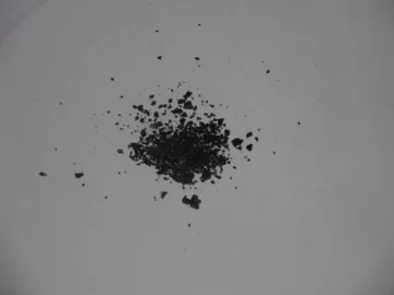

    I ran the soot eater and got about 1/2-3/4 cup of this. It is very dry barely makes your fingers dirty when you rub it between them. It is black and brown. There is a little shine which concerns me because I'm no expert. What do you guys think? For perspective that is maybe 1/4 teaspoon in the middle of 10" paper plate. I made an appointment with a sweep for next Thursday, should I keep it?

  22. milleo Feeling the Heat
    joined: Aug 8, 2011
    297 posts
    Maine
    fire the stove up and see if anything has changed on how it burns.
