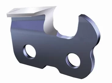

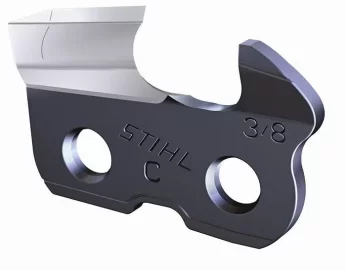

  11. bogydave Minister of Fire
    joined: Dec 4, 2009
    7,988 posts
    So Cent ALASKA
    +1 for RS
    But RS & RS3 are the same cutter. Should cut the same speed all being equal. Just some safety built into in the RS3.
    What am I missing? Isn't a little safety built in a good thing?
    But why not the RS3 ? The the safety "single humped drive link" only comes into play on the nose area of the bar where kickback is caused.
    Whe the chain rolls over the nose the hump sticks up to keep the cutter from digging in deeper if the nose gets into wood.
    It reduces kickback but don't totally prevent it. The rest of the time it is even with the raker just like the RS.
    Why is the RS better than the RS3 ?
    RS3: RS3.jpg
    The RS is the same cutter but no "humped drive link".
    I don't see where it would be faster it you are not using the nose of the bar. Should cut the same as the RS3.
    When you file the raker, you also file some of the hump on the drive link.
    RS: rs.jpg
    The Oregon LPX is similar to the RS3, a little kick back reduction & smoother cutting, where
    the LGX is similar to the RS, no kick back reduction.
    Also FYI:
    Quote from stihl: "RS3 chain typically cuts faster than RM chain, but requires careful sharpening and maintenance to continue to perform well."
    RM is a little better if you are cutting dirty stuff, don't dull quit as fast & like Sthil says, gotta keep the chisel chain sharp to perform well.
