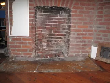

I'm thinking that it would be great to reline the old firebox with soapstone tiles. The old bricks are in terrible shape, some are badly broken, mortar is missing, etc. The firebox is going to need work anyway, and suddenly soapstone tile seems like a brilliant idea. It should help hold and reflect heat back into the room and will look way nicer for a long time.
What the best way to fasten Wonderboard to the old brick? Is Wonderboard the right stuff? Do the tiles go on the board with thinset or refractory mortar? Should there be a spacer (for dead air space) between the Wonderboard and old bricks? (although i don't want to loose to much width; the dims inside are 36 h x 26 w x 14 deep).
I'm attaching a photo of said firebox ( I think...?). Yes, it's weird and the hearth that extends out into the room is 2 inch thick slate on about 6 inches of ancient dust and dirt and sand. The slate is broken into three pieces and needs to be replaced. I'll save questions about that for another post...
