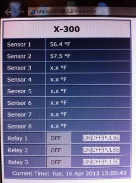

    yup, controlbyweb.com i wish i could offer more insight but i still need to hook my x300 up. here is a snapshot from a quick test i did. in the coming weeks i will have all 8 sensors hooked up that i can view from any computer or even my iphone. can also control 3 relays either manually, timed, or by setpoints of thermal sensors. i will use one to turn on oil burner head when storage temp falls below 140*. one to turn wood boiler off when storage hits 200*. and the last relay for the block heater on my truck. :) the only thing is that you need to have an internet wire run to the control unit and also change something with IP addresses that i will need to figure out as well.
