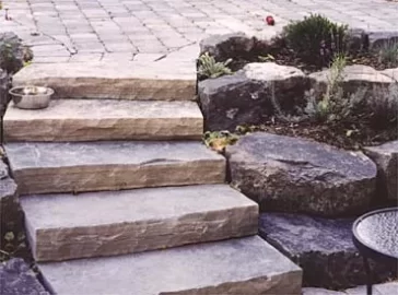

    Here is a job we did using "armour stone" It is my favorite look for a retaining wall. At 2.5ft it will be no problem 2 large rows (16" tall stones) will look nice. You can make it flow with the existing lines of the property, set the stones tight to each other or leave space between rows for planting if you like.
    Construction is fairly easy as long as the access is good. Tools needed a tree dolly which can be rented and a 4ft pinch bar. The stones are very heavy but suprisingly easy to move if you work smart, at most you are just rolling them over.
    The key is to get "blocky" or squared off stones. I like them just abit bigger than a milk crate, for easy handling but it will look best if you match the size of stone to the overall project. Set the first row a few inches into the ground and pick stones that fit well together, if there are gaps between stones the edge of one can be set behind the other. Put filter cloth or landscape fabric behind each row and you will have no erosion.
    The pic is not the best, the bench is in the way but it will give you an idea. This job is almost 10 yrs old, it's my mothers house.
    You can google image "armour stone" for more pics.

    Gunner, beautiful job, much like what I would like to do here in my backyard in NH which is already covered with granite terminal morrain boulders. What is "armour stone"?

    Gunner, very impressive work. The steps alone are awesome. Such large stones would be a real burden for me personally. I've got a bad back, and generally avoid lifting anything more than 60lbs if I can. I could use chains, my engine hoist, or just roll them around I'm sure and get the job done with some help from friends, but I think for my health I'll stick to a lighter construction technique.

    "armour stone" in this neck of the woods is reffered to as "Rip-Rap"...
