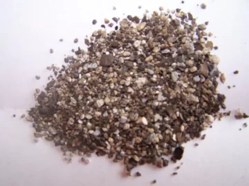

It looks like sand, feels like sand but when i grind it between my fingers most of it breaks down. Any idea what this stuff might be? Does anybody else find this stuff in their burn pot?

So that's what a clinker looks like! never had this issue before. Is it because of poor raw material being used?
If you have a propane torch gather those up in a pile on a non combustible surface outdoors and torch them just to make sure it is all mineral.
But as clinkers go those would be classified as babies and if tossed out of the pot by the air flow as not a problem.
So i don't have to worry about them destroying any internal moving parts?

Was that in your hooper or in your ash?
They are not clinkers unless they result from burning.
If that was in the bags or on the bags then you have a matter to take up with the pellet maker or the place you bought them from or yourself if the stuff was from say your yard.

They were in the burn pot, so far my stove chow has little to no fines which i can't say about my Greene team.
No not really, You need to melt that all together to get a clinker. If you crank the heat up some they might form a good one.
The lighter pieces are probably chlorides and the darker brown ones are most likely carbon deposits. Wood absorbs minerals from the soil they are growing in. Some grown in marsh/swappy area's tend to have more. Trees grown in a brakish region will have more chlorides(salt). So depending on where Energex recieved the fiber from for the batch of pellets your burning. If there is sand in it it could be from the yard. The chips are dumped on the ground and them trasported to the mill. If they scooped up some dirt/sand it will end up in the pellets. If the batch of fiber had lots of bark in it it will also end up in the pellet. Some will settle to the bottom of your burnpot. So, "yes" on the raw material!

OK so i'm not going to worry about them, thanks for the info everybody.
