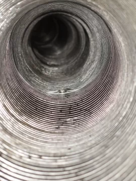

    Unrolled my second Flex King Pro chimney liner from Chimney Liner Depot today and it is defective like the first one 2 weeks ago. When you unroll it across the flat floor the inner smooth wall coils pop in and buckle various places throughout (no shipping damage, no dents on outsides, perfectly round)
    The first one I can understand but now the second one too... They were easy to deal with when I called about the first bad one, a pic of it and a phone call and they sent a replacement.
    Should have went with Rigid like I planned before they told me this way was cheeper and worked just as good ? I questioned cheeper, but the reviews on here seemed to be good also.
    Hope the turkey turns out better than this flex liner project has !
    What would You push towards, or do ? Todd 2

    Speaking of turkeys... After receiving 2 in a row bad one has to question the quality of the company's products for sure.

    You can buy 50 of those "smooth wall" liners and they are all gonna do it somewhere. One of the reasons I pulled mine and replaced it with single wall.
    If you can reach most of the "puckers" with something tap them back down.

    Thanks for the info BB, I did try on the first one to tap them back down since they did not want it back, but that SS acts like spring stock, it pops right back in. Wonder if I would pay the difference to get rigid, they would do that ?

    Just have to ask them. I really don't think the puckers hurt much of anything since there is a sealed single wall liner around the inner part. I think I over reacted on mine but I also had to ovalize it and that made the problem worse.

    Are those "puckers" going to catch and rip when you sweep it in the years to come?

    Hi bert, that is what I was thinking, it is like a 3/4" strip rapped inside, you snag it with a brush it will unravel and pull out, let alone a place for stuff to build up during use. Might even come unraveled with expansion and contraction. Smooth inside was the whole concept one would think. Todd 2

    i just installed one of those and the same thing. home owner wanted it in.
    i believe its just what happens with those type liners.

    Don't worry about that. I have that liner in the woods out back. Good luck pulling that strip loose. Tried it. It is crimped with the outer liner. If you install the liner orient it with the open side of the strip up so the gases flow smoothly up the pipe. Some don't include that in the instructions.

    Them puckers just stroke my fur backwards though Bart. You pay good money for something and you expect it to be right, sorta like buy'in a brand new car with a cracked windshield. I guess Im just to picky, but they will be hearing from me again monday morning.
    I asked them (the first one bad with puckers) if that was a defect and they said yes, it should be smooth all the way through, so Im gonna try to bargain for the rigid since mines a straight shot install. Should of stuck with my first plan:( Know what I mean ?

    What you need is something you are comfortable with when you are burning a fire in your house. Period.
