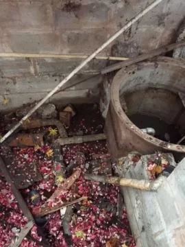

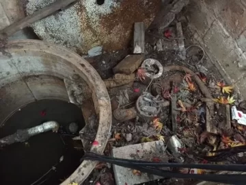

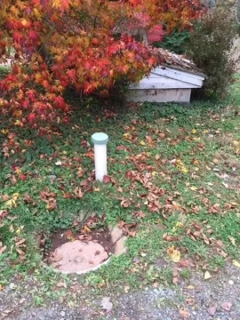

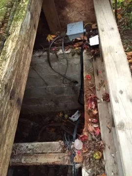

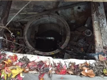

I have some pictures here from the setup that is currently at the house. Has anyone ever seen anything like this?
Right now the pipe comes off the house and runs into the center of the circular driveway. There is three cleanouts then it dumps into what looks like the solids tank. After that the bigger tank looking is next down the line. Im hoping that this was just neglected and the wiring would need to be redone. House has been abandon for about 1.5 years. I think this worked before the guy left but the little roof thing over this hole rotted away and rusted the stuff below.

That almost looks like the wiring for an ejector pump or does this have to pump up to the leach field? The third picture makes it look there was some older pipe with wires and junction boxes with seal offs. The pipe in the pit looks like it has a union it it for removal of a pump for servicing.

it does look like an ejector pump, maybe the field is uphill

What are the small pipes for? They don't look like waste plumbing. I hope that mess isn't the well!
Looks like you found an abandoned well.

Given that you're on a hill and see no gravity drain leach field area you could have a pressurized field. What you've found looks to me like the "distribution" box for the field. The septic tank is probably under the access cover in your first photo and liquids from the septic tank flow to this vault for pressurized distribution to the field uphill of the house.
It could also be a well as someone else mentioned but I hope not.

A good septic person should be able to find your tank and other components with a ground probe and tell you what you have.

Looks like a pump chamber. It also looks like those old rusty boxes that don't have covers may have been abandoned at some point in time. There looks to be some newer black SJ or SO cords coming up to that gray junction box, there may be a piece of UF wire feeding the box. I'm not sure what size tank that is, but it looks overfilled. An electrician should be able to figure if the pump/floats are good or not without having to get down in the peww.
