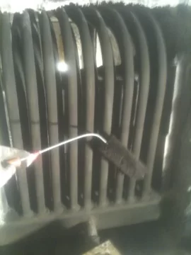

About 3 times a season I take the back off my Seton and clean the back tubes that I caLink Removed nt reach from the front of the boiler. This was a nasty 4 hour job the first time I did it. I've been trying to improve on the cleaning time since then. Last night I set a personal best time of 45 minutes from the time I cracked the first nut until ready to burn again. Here's what's changed:
1) no creosote - storage, no cycling, and 2-3 year dried wood have eliminated creosote. So there's no tube scraping needed, just dusting.
2) good bristle brush. Grainger sells a 27" long twisted wire brush thats 2"diam and has a 6" long section of bristles. (Tough Guy 3EDP6). This worked well on the back and its even better for cleaning the overhead tubes from the front. The long, fairly strong handle can be bent to reach most of the way down the vertical section of tubes.
3) I use aluminum foil tape to seal the holes around the water return instead of silicone.
I took a picture of the tubes and brush after dusting.
here's the pic. just thought this might be useful to other Seton owners.

Looks fantastic Mole! Cleaning Seton type boilers is one of the absolute worst jobs imaginable.
When you burn, are you burning a complete load of wood with basically nothing left? Or are you able to stir up hot coals to rekindle the next fire?

Yeah, it's a real sucky job. My wife always laughs at me when I come upstairs from cleaning it. It reminds her of Burt from Mary Poppins! I make a hot fire in the evening that burns hot for 4-6hrs, then I let it burn out as the tank comes up to temperature. I never have any coals from the day before. I rake the ashes to the front of the boiler before each fire and empty it frequently so there's little ashes for any coals to hide in. I feed wood into the fire every half hour to hour maybe, trying to maintain a stack temp of 450-550 deg, rather than burning a "batch" of wood at a time as a lot of people do with these things. I think it burns cleaner if you keep the temp up.
